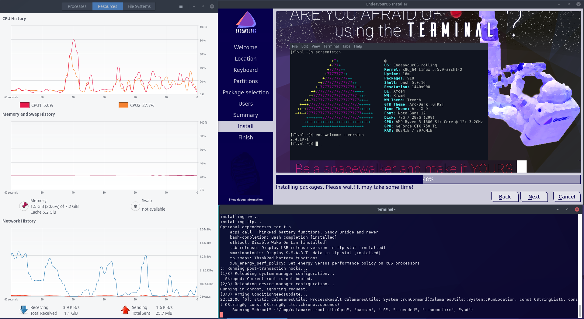

Now for my issue or rather a suggestion. Can we put up more logging about what and how Calamares is doing with my network during online install? atm i am stuck which just this screen:
reflector returned error code 1, mirrorlist not updated.
warning: dependency cycle detected:
warning: harfbuzz will be installed before its freetype2 dependency
warning: directory permissions differ on /tmp/calamares-root-db2wok9w/run/
filesystem: 1777  package: 755
rm: cannot remove '/tmp/chrootpath.txt': No such file or directory
rm: cannot remove '/tmp/packages_list.txt': No such file or directory
rm: cannot remove '/tmp/new_username.txt': No such file or directory

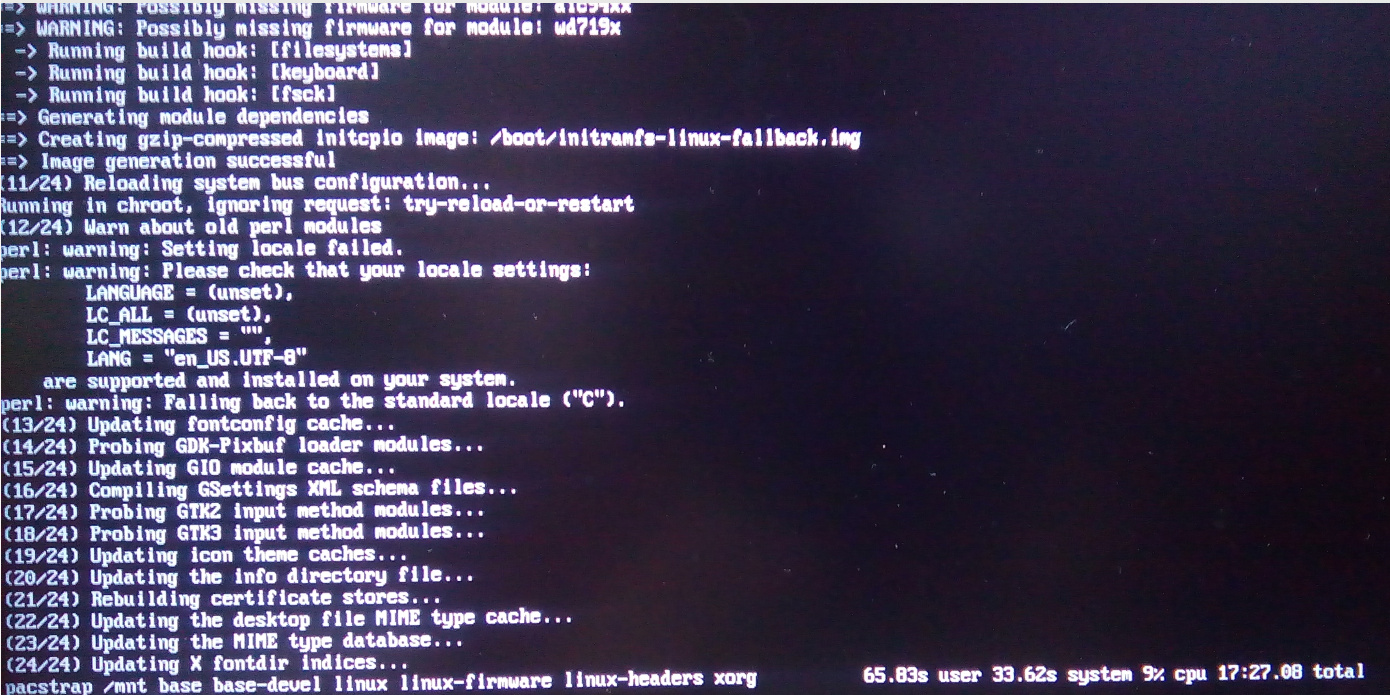

for about 10-15 minutes while my networking monitor has been spiking at max speed. This is just using a base-devel+common package install and this took longer that i am to install base+base-devel+base-xfce4 on a vanilla arch installer.
just for comparison (screenshot did not include the DE components installed during pacstrap)
