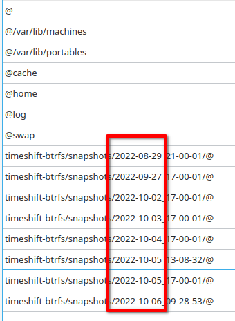

I have a strange issue with btrfs-assistant and Timeshift snapshots.
My snapshots are up to date: (February 2023)
But in Btrfs-Assistant, when I include them, I only see old snapshots from October 2022 !!!
No idea where this comes from, as in TimeShift I have deleted those old snapshots since a long time ago. It seems Btrfs-Assistant is “stuck” with something… somewhere. No idea how to debug this.
If it can help, I switched from Grub to Systemd-boot following @dalto tutorial, more or less around last October… so maybe it is related, maybe not.
Should I uninstall and reinstall Btrfs-Assistant ? Something else ? Thanks for your thoughts…

Can you share the output of sudo btrfs sub li /
