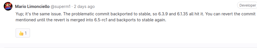

From the following comment from the link I posted earlier, I understand that the previous LTS version(6.1.35) was also affected. It would make sense not to update LTS so often, i.e. to put it in the IgnorePkg of pacman.conf.
I’ve done some more debuging regarding what messes things up for me. It is not the kernel directly but the linux-firmware package!
https://archive.archlinux.org/packages/l/linux-firmware/
The onces in the red box doesn’t work
linux-firmware-debug
After rolling back this to the 25-Apr-2023 version everything works fine, meaning linux and linux-headers works in their latest version
Just to follow up on this.
I finally was politely redirected to the correct issue for my problem:
https://gitlab.freedesktop.org/drm/amd/-/issues/2666
