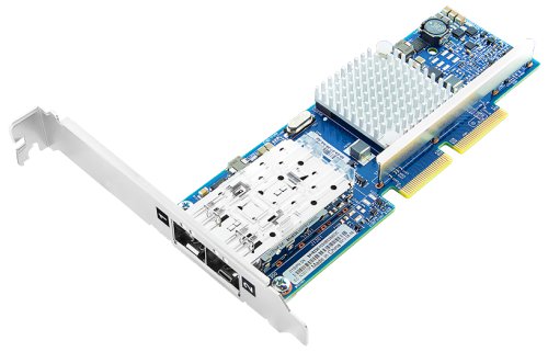

Yours is a 10GB nic correct?
Correct. Dual port 10gb with sfp+ slots. I am connected via twinax.
Something like this?
Broadcom NetXtreme II ML2 Dual Port 10GbE SFP+
