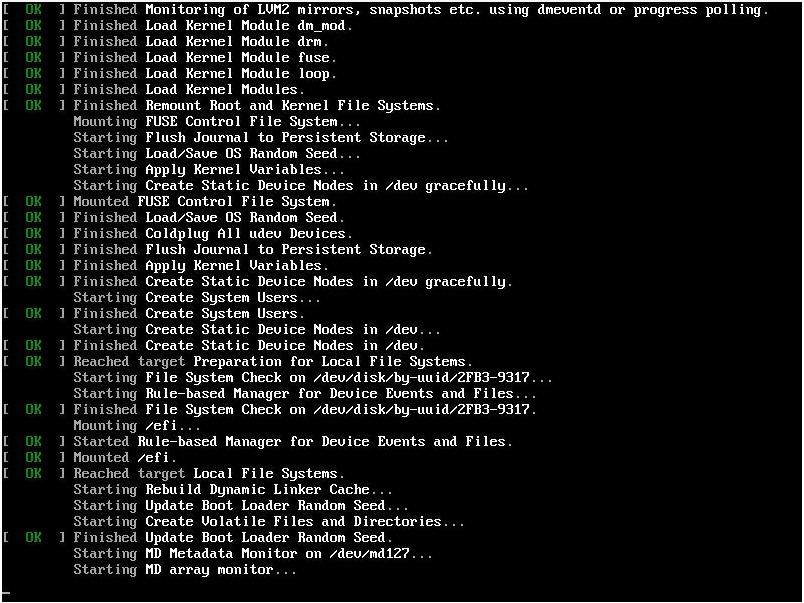

This got me past the “not found” error but now I just have a hang with nothing to go on.
Any ideas on what it might be, or a process for debugging the boot sequence to determine the cause of the hang?
Try setting loglevel=7. That should dump quite lot of info.
Appreciate the help.
Log 7 definitely got more info but no smoking gun.

I might try installing the LTS kernel in the arch-chroot. Make sure this isn’t another kernel 6.5 issue.
Well, I figured out the proximate issue.
I was managing the machine via the virtual KVM functionality of the motherboard’s built-in BMC (over ethernet).
Somehow was preventing the DE from starting when using 6.5.
I installed linux-lts and that fixed the issue.
So I can either run on linux-lts and have access to KVM remote management via my BMC or I can run 6.5, but only with direct display output.
Problem solved!!
