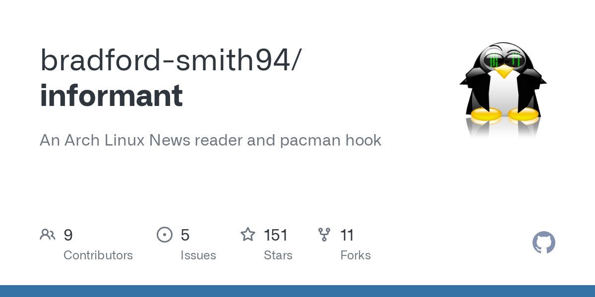

Does this sync the local package database before aborting if there are unread news?
This is the hook:
[Trigger]
Operation = Install
Operation = Upgrade
Type = Package
Target = *
[Action]
Description = Checking Arch News with Informant ...
When = PreTransaction
Exec = /usr/bin/informant check
AbortOnFail
The trigger is “Upgrade”, so I believe it does… If I’m right, it could be potentially harmful to use it, as it could lead to a partial update.
It is a pretransaction hook. I am nearly certain those run after the db sync occurs.
So if you have unread news, it’s basically like running
pacman -Sy
Fortunately, it prevents you from installing any new packages, so that’s good, as that would cause a partial update.
EDIT: but not really… Here is the scenario:
You have unread news.
You try to update. It fails, but the db is synced.
You read the news.
You install a new package – partial update!
Unless you try to update, have it fail, read the news and decide to deal with it later.
