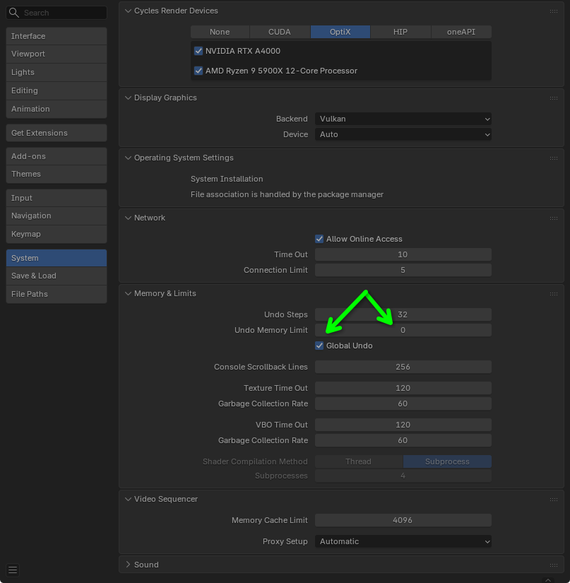

I’m less experienced with Blender, but I can’t say I’ve noticed the issue you’ve described. In Blender, what have you got here?

Turns out i am slightly dumb. I have English and another keyboard language installed, shortcuts do not work with the other language. Problem solved (once again probably, i think i had figured that out and with time i forgot).
