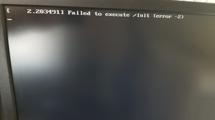

Blank, unresponsive screen after boot

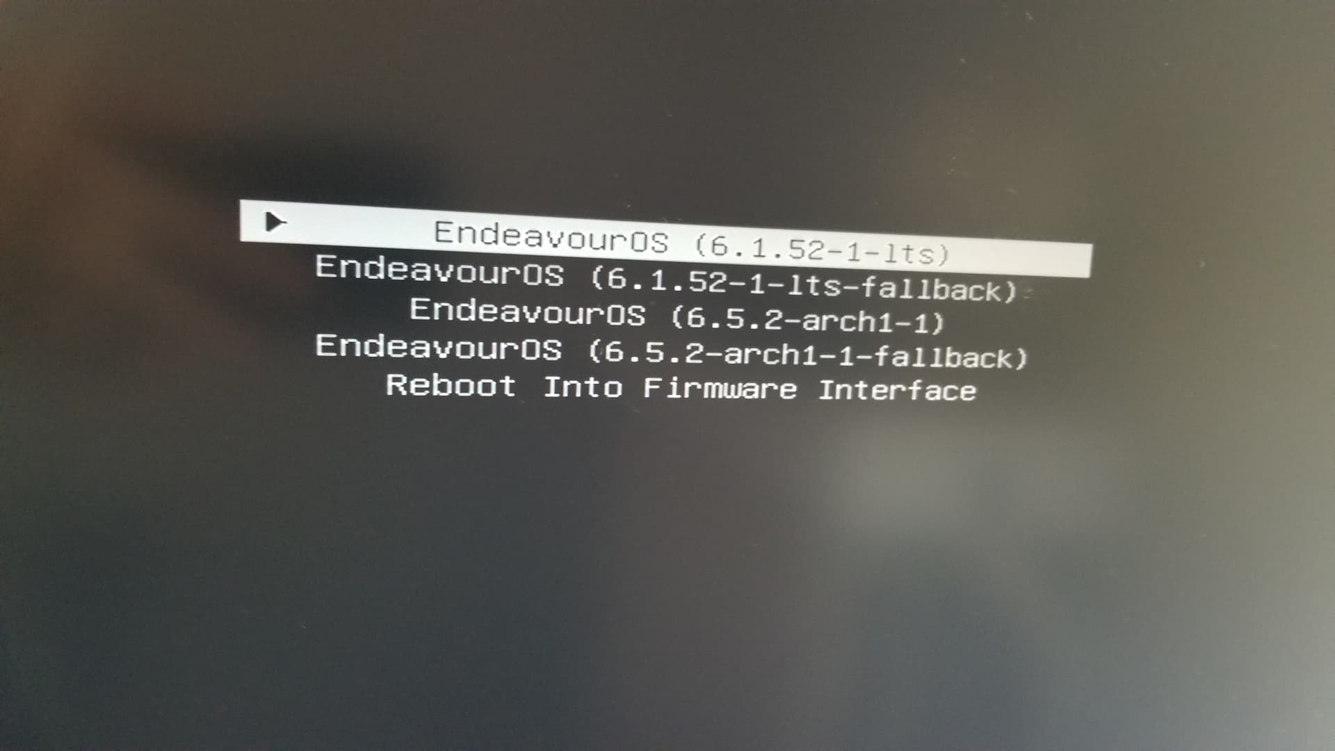

Here is that as well:
Here is the screen if I select the 6.5.2 option (it was blank earlier, now just shows this)
That error usually means something is very wrong with your filesystem.

dracut: Skipping udev rule: 70-persistent-net.rules
dracut: *** Including module: dracut-systemd ***
dracut: *** Including module: usrmount ***
dracut: *** Including module: base ***
dracut: *** Including module: fs-lib ***
dracut: *** Including module: shutdown ***
dracut: *** Including modules done ***
dracut: *** Installing kernel module dependencies ***
dracut: *** Installing kernel module dependencies done ***
dracut: *** Resolving executable dependencies ***
dracut: *** Resolving executable dependencies done ***
dracut: *** Hardlinking files ***
dracut: Mode:                     real
dracut: Method:                   sha256
dracut: Files:                    743
dracut: Linked:                   2 files
dracut: Compared:                 0 xattrs
dracut: Compared:                 41 files
dracut: Saved:                    356.65 KiB
dracut: Duration:                 0.010828 seconds
dracut: *** Hardlinking files done ***
dracut: *** Generating early-microcode cpio image ***
dracut: *** Constructing AuthenticAMD.bin ***
dracut: *** Store current command line parameters ***
dracut: *** Stripping files ***
dracut: *** Stripping files done ***
dracut: *** Creating image file '/efi/4110677136a94a3aa0590704c453f8e5/6.1.52-1-lts/initrd' ***
dracut: *** Creating initramfs image file '/efi/4110677136a94a3aa0590704c453f8e5/6.1.52-1-lts/initrd' done ***
Does it work now?
Doesn’t look like it. Tried both the 6.1 and 6.5 options. Only change I noticed is that there is the 6.5 no longer has any text output.
Decided to reinstall after trying a few different things. I appreciate everyone’s help regardless! Also installed the LTS headers on initial install this time. I’ll be more careful on changing anything moving forwards, this process has familiarized myself with a lot of forum & wiki resources
