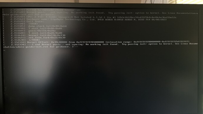

Same issue after sudo reinstall-kernels and yes, I wasn’t able to get to get into tty. Just to confirm, the bootctl command returned yes.
Here is the LTS Kernel error in specific:
Kernel panic - not syncing: No working init found. Try passing init= option to kernel.

You’ll find that I ended up installing grub as well on my solution finding journey before realizing the difference between it and systemd-boot, I will figure out how to safely remove it later.
Are you sure you aren’t booting off that broken grub now?
I would try running bootctl install from within the chroot.
I did attempt it earlier, but I’ve been using the “Linux Boot Manager” to boot since this process started, which I think is systemd-boot?

Can you share cat /efi/loader/entries/*
Here you are:
[root@EndeavourOS /]# cat /efi/loader/entries/*
# Boot Loader Specification type#1 entry
# File created by /etc/kernel/install.d/90-loaderentry.install (systemd 254.1-1-arch)
title      EndeavourOS
version    6.1.52-1-lts
machine-id 4110677136a94a3aa0590704c453f8e5
sort-key   endeavouros-6.1.52-1-lts
options    nvme_load=YES nowatchdog rw root=UUID=72afc726-c5b1-4ec2-a2ca-7bf88cf5e122 systemd.machine_id=4110677136a94a3aa0590704c453f8e5
linux      /4110677136a94a3aa0590704c453f8e5/6.1.52-1-lts/linux
initrd     /4110677136a94a3aa0590704c453f8e5/6.1.52-1-lts/initrd
# File created by /usr/lib/kernel/install.d/90-loaderentry-fallback.install (systemd 254.1-1-arch)
title      EndeavourOS
version    6.1.52-1-lts-fallback
sort-key   endeavouros-6.1.52-1-lts-fallback
initrd     /4110677136a94a3aa0590704c453f8e5/6.1.52-1-lts/initrd-fallback
title      EndeavourOS
version    6.5.2-arch1-1
sort-key   endeavouros-6.5.2-arch1-1
linux      /4110677136a94a3aa0590704c453f8e5/6.5.2-arch1-1/linux
initrd     /4110677136a94a3aa0590704c453f8e5/6.5.2-arch1-1/initrd
title      EndeavourOS
version    6.5.2-arch1-1-fallback
sort-key   endeavouros-6.5.2-arch1-1-fallback
initrd     /4110677136a94a3aa0590704c453f8e5/6.5.2-arch1-1/initrd-fallback
Can you take a picture of the actual error message?
Sure!
Can you take a picture of the boot menu before you get to that point?
