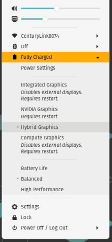

Maybe if you are going to try another distro. Try PopOS because they have a Hybrid graphics setting and they have an Nvidia ISO to download also. So make sure you download the Nvidia ISO. This is what i would recommend because they do a good job with Nvidia. It would be interesting to see if it works or not.
That is true, pop os could work. careful to not use wayland session, it does not bode well with nvidia, not sure whether they run xorg but I had some screen freeze after a while…
I don’t think they would use Wayland on the Nvidia as it is my understanding Nvidia so far hasn’t worked well on Wayland but it’s coming. But, I’m not sure on it either. I’ve never really noticed the times ive had it installed.
