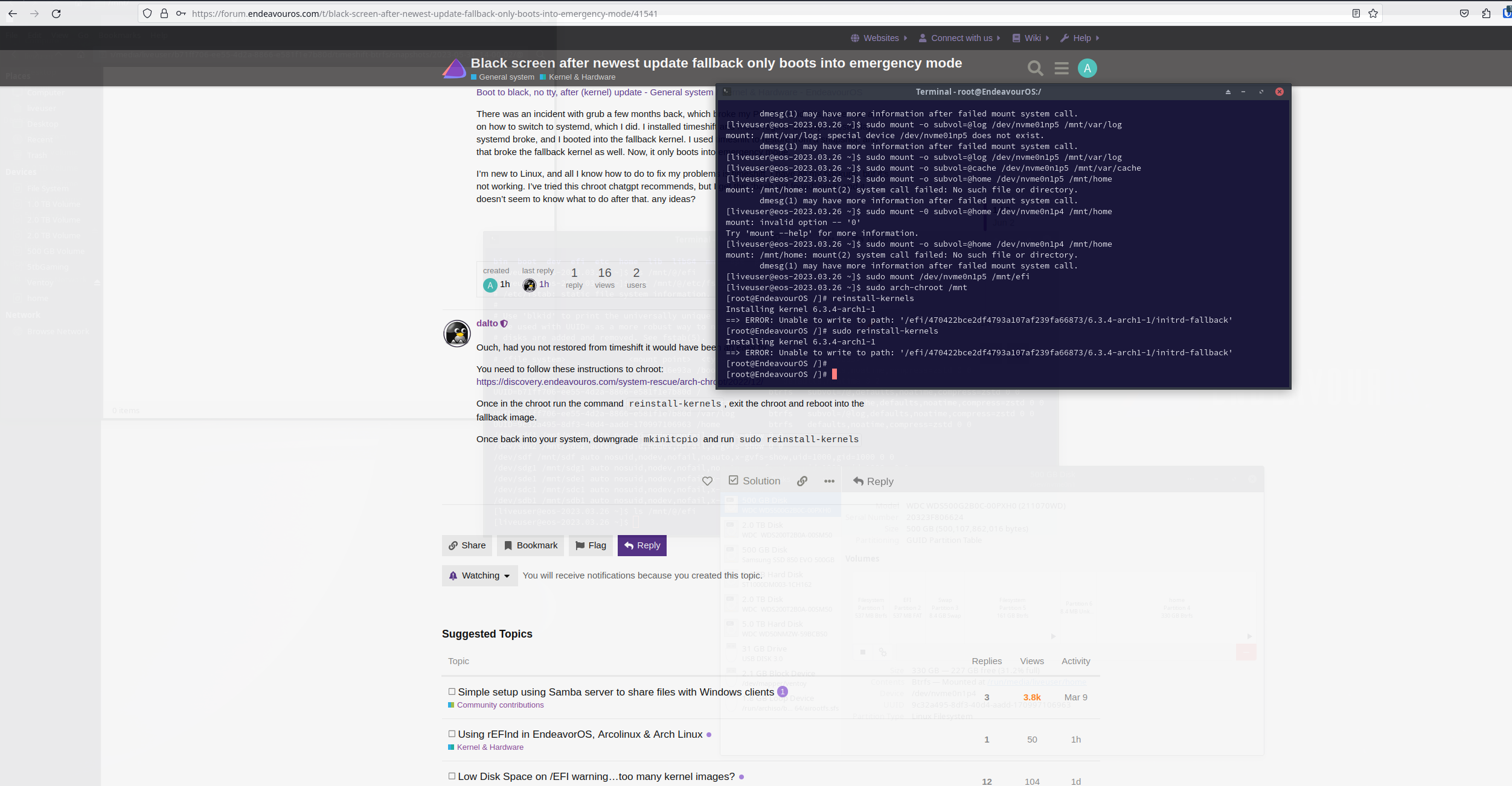

the reinstall kernels did not work
What does find /efi return? Please post it is as text instead of screenshot.
that command returns so much text that pasting it all exceeded that amount of kb that pastebin allows
It looks like you mounted the wrong partition on /mnt/efi
i get vfat not recognize when i try to mount nvme0n1p2
It looks like both p1 and p2 are EFI partitions. You should look in fstab and see what is mounted at /efi
it says it’s the p2
Can you share the output from when you try to mount it?
[root@EndeavourOS /]# sudo mount /dev/nvme0n1p2 /mnt/efi
mount: /mnt/efi: unknown filesystem type 'vfat'.
       dmesg(1) may have more information after failed mount system call.
Are you inside the chroot? That error usually means you are missing kernel modules which shouldn’t be the case. What ISO are you using?

[root@EndeavourOS /]# sudo mount -o subvol=@ /dev/nvme0n1p5 /mnt
[root@EndeavourOS /]# sudo mount -o subvol=@log /dev/nvme0n1p5 /mnt/var/log
[root@EndeavourOS /]# sudo mount -o subvol=@cache /dev/nvme0n1p5 /mnt/var/cache
[root@EndeavourOS /]# sudo mount /dev/nvme0n1p4 /mnt/home
[root@EndeavourOS /]# sudo arch-chroot /mnt
sudo: arch-chroot: command not found
i don’t know, i followed the instruction as it was presented, I’m no so knowledgeable that i can be creative with this. i unmounted everything and mounted again as pasted above
the arch-chroot is working after installing the arch-install scripts but still vfat is not working
