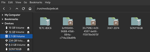

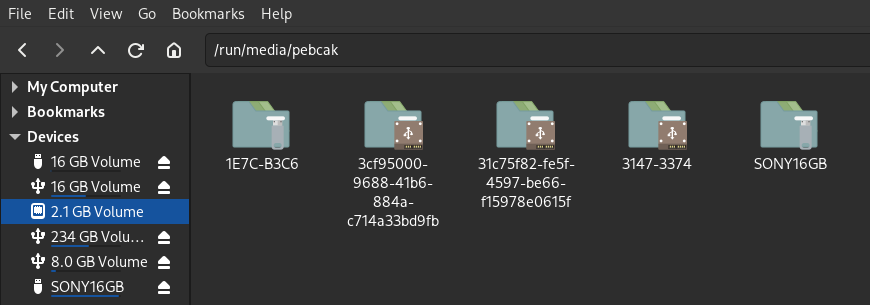

Under GNOME-Wayland, whatever removable storage device I may have plugged in at boot are automatically mounted at /run/media/$USER
Also under the running session, whatever other removable device hot-plugged into the system will be automatically mounted at said location.

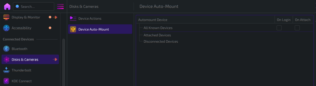

Adding this for Plasma 6 context
System Settings > search “device auto-mount”, or
System Settings > Connected devices > Disks and cameras > Device Auto-Mount
Great! That’s exactly what I had on my mind though it looks a bit different now.
Thanks!
Doesn’t look much different to a Plasma 5 installation, but I rarely use these settings. I am a CLI guy with the occasional browsing, which I have to do in a GUI. Note the ‘on login’ and ‘on attach’ columns. This makes it clear that a mount won’t happen before login.
