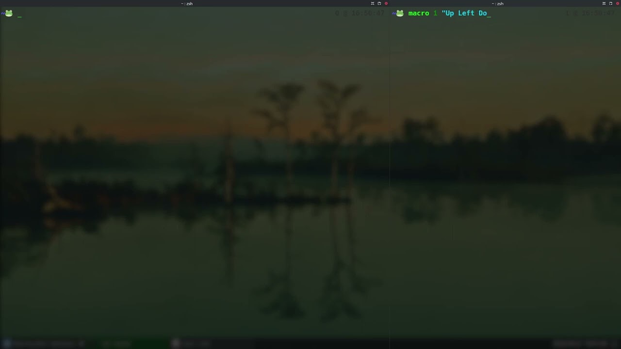

Here is a video demonstration of it:
There, you can now have macros in any program, and you can go back to using your lame text editor and forget about Kate. :wink:
