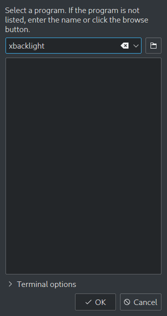

I feel really dumb, but how do I make my brightness keys working on Plasma? :sweat:
It is normal that they do not work out of the box (it’s often the case), I usually just define custom keybindings somewhere or look for a related option in the menus. But neither brightness nor backlight seem to give any result in the System Settings menu search. And I can’t figure out where do I bind custom commands to keys. I tried to do it in Custom Shortcuts, choosing Run in terminal, but apparently I’m doing something wrong as it seems I can’t just write xbacklight -inc 5 or whatever, but only to choose an app to run? :crazy_face:

Any pointers to where I can find either backlight settings or set my custom commands are welcome.
Pick the program, ie xbacklight and then you will get a dialog where you can add arguments. You probably don’t want to run it in a terminal though.
Also, did you look here? It should work out of the box:
In that menu? It seems I can’t ?
See above, I edited before you posted.
Did you “click the browse button”? :wink:
I did now :sweat: Still can’t find where to put the options… I can’t type them.
I don’t seem to have it? Maybe I’m missing a package? I installed only those you’ve suggested earlier…

How about installing powerdevil
Just installed it. The Power Management entry has not appeared though. But it definitely recognizes the keys now, I’m getting a “No service configured” pop-up when I press them.
Before that nothing was happening at all.
You could try kgamma5, did you restart since adding the package?
Installed kgamma5 and rebooted. I don’t know what helped in the end, but the Power Management entry is here now and the default Monitor Brightness Up option appears to be working. Thank you!
