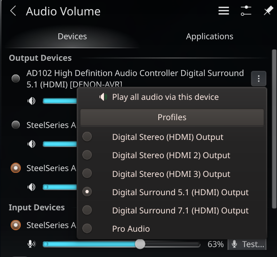

Did you run your setup using nvidia or default ? The nvidia drivers might not be installed and you might be running on Nouveau.
Try running :
sudo nvidia-inst -t
What does it say ? I personally run on a 4090 and I’m using a similar setup with a Denon AVR-S970H in 4K and with the 5.1 profile working.

Answering my own post so I can flag this as a quick solution without wall of text:
The attached TV (the monitor) is stereo and this is what gets detected. The capabilities of the receiver don’t play a role here, even though it is set to 5.1. This is an EDID handshake issue (AI was really helpful for a change to find this out)
To overcome this, the module option options snd_hda_codec_hdmi static_hdmi_pcm=1 needs to be set.
Make a file with sudo vim /etc/modprobe.d/nvidia_hdmi.conf and put the above line in.
Reboot and change audio settings. That’s all that’s needed.
