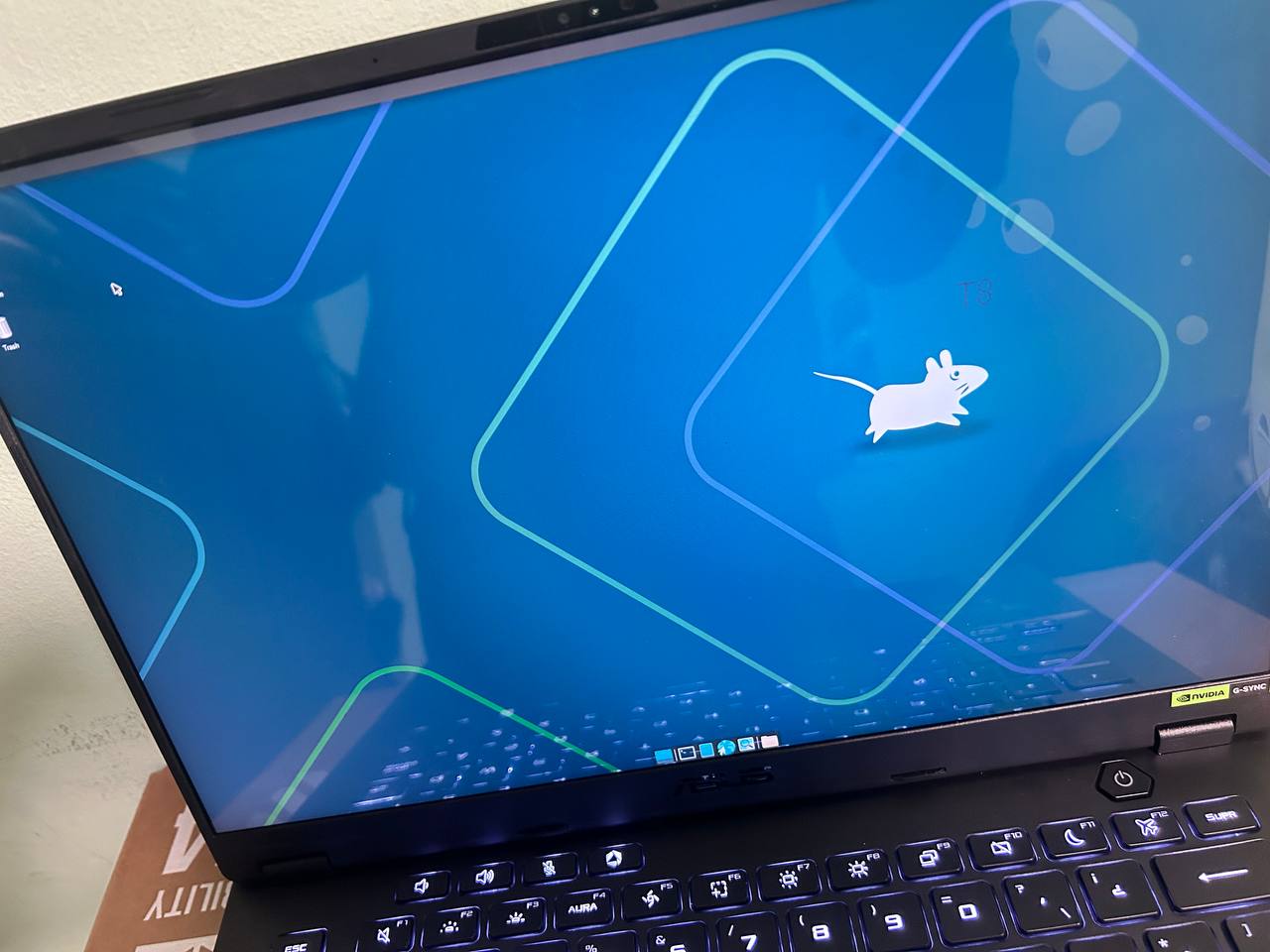

ASUS TUF A14 - Latest Nvidia Driver Black Screen
After a fresh install of EOS Ganymede, I’m left with a Black Screen (of death).
Have done everything I can to fix it: uninstalling drivers, installing drivers, loaded/unloaded modules… and nothing. Like, doesn’t even run on the amdgpu for some odd reason.
Wonder I have to install prime-run, and the lib32 packages :thinking:
BTW, using Ly as my login-manager because… it’s cool :smiley:
Awaiting your help to help me debug this mess :folded_hands:
Posting logs for debugging:

It shows nvidia 590xx version installed but is not rendering on the nvidia gpu.
API: OpenGL v: 4.5 vendor: mesa v: 25.3.3-arch1.1 note: console (EGL sourced) renderer: llvmpipe (LLVM 21.1.6 256 bits)
This is a Max Q Hybrid laptop. What method are you using to switch from the amdgpu to nvidia?
At this point nothing. Did install nvidia-prime, but thought that came out of the box when you installed the drivers. Was using EnvyControl but that’s also pretty messy.
Do you suggest something better?
What does running this show. It’s just a test. See what the output tells you for the drivers. You should be using nvidia-open-dkms
nvidia-inst -t
You could make sure prime and envy control are uninstalled. Then try reinstalling the drivers manually.
sudo pacman -S nvidia-open-dkms nvidia-utils Then boot and see what inxi -Ga shows
There is also asusctl and supergfxctl in the AUR. I’m not sure if they are just for ROG model laptops? I think they work on others too.

Also, installed: asusctl, rog-control-center, envycontrol (for GPU Switching). Modified the Kernel to early load both amdgpu/nvidia drivers, and disabled the kms module too.
Now, when running with Integrated graphics (amdgpu) it does load the Display Manager (lightdm), when running on Hybrid/Nvidia modes, the DM fails to load and goes into a black screen, so something is happening there.
Have to stop the DM from starting, and have to run “startx” to initiate a session. Had to install “xorg-xinit” and create a .xinitrc file with the “exec startxfce4” parameter.
Once in, I notice lots of screen glitches/artifacts happening.
Funny enough, had no issues running Wayland tho, but the DM wouldn’t load either sadly :frowning:
Only Xorg is the culprit here >_<
Not sure why it wouldn’t work with EOS, since pretty much the same packages were installed too. It’s progress but some things need to be worked on…

Still testing for now. Very odd case here, as xrandr reports several screens, and now have a PRIME screen I cannot get rid of :confused:
And performance with the open-nvidia-dkms driver is sub-optimal here: random glitches, freezes, lag, etc
