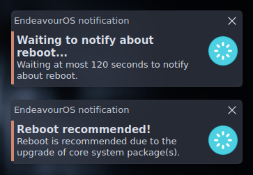

Anyone else get the hilarious notification notifying you of a future notification a few seconds later?

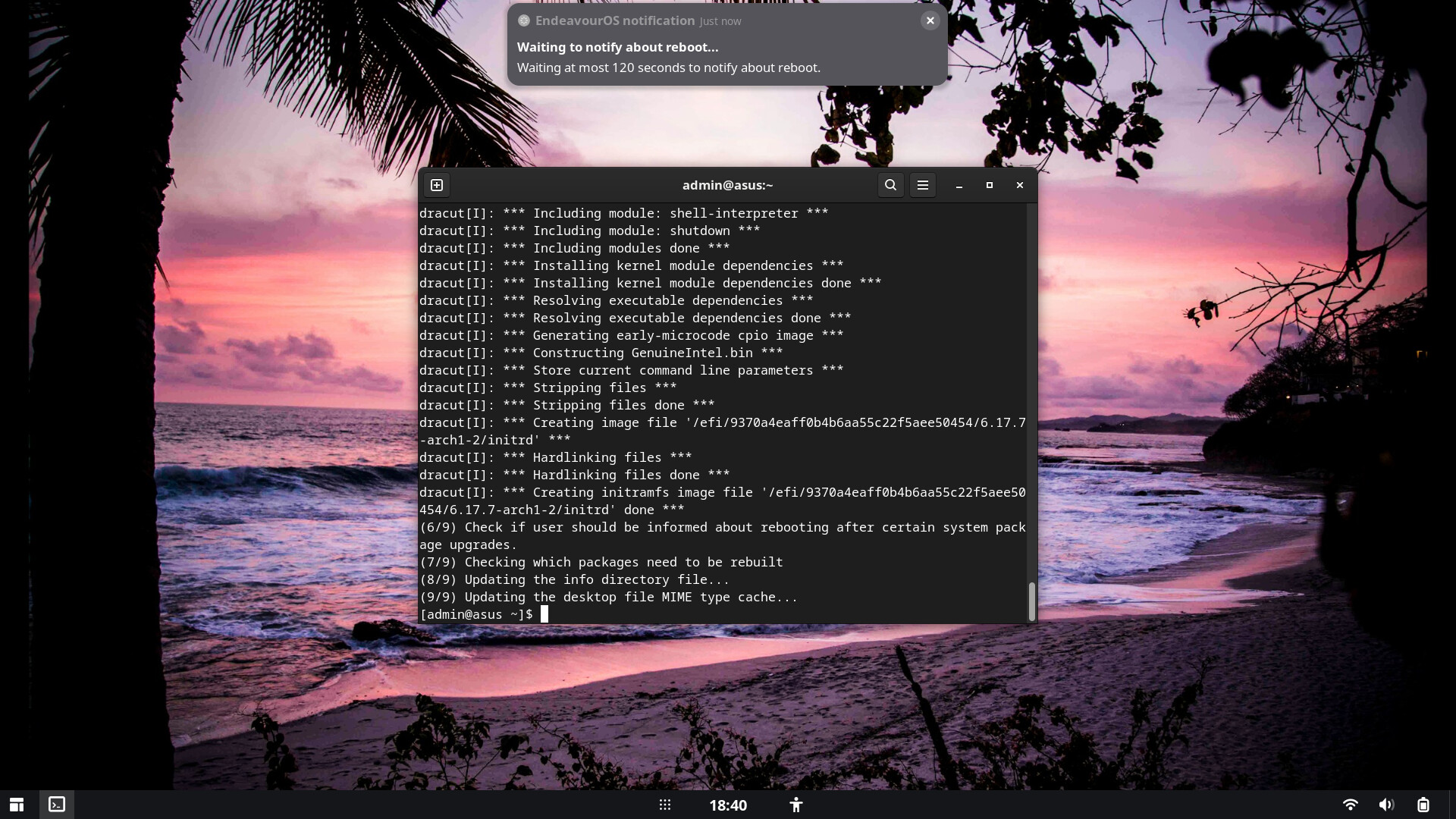

At the end of an update, it started happening to me immediately before the regular reboot notification
I screencapped it just now. As soon as I close it, the reboot one pops up in its place

Did you also have AUR or any other unofficial repo in your updates in your updates? Looks like the official repos were finished & waiting for non official repos to get finished. . So, you get notified that your reboot will take place after a while.

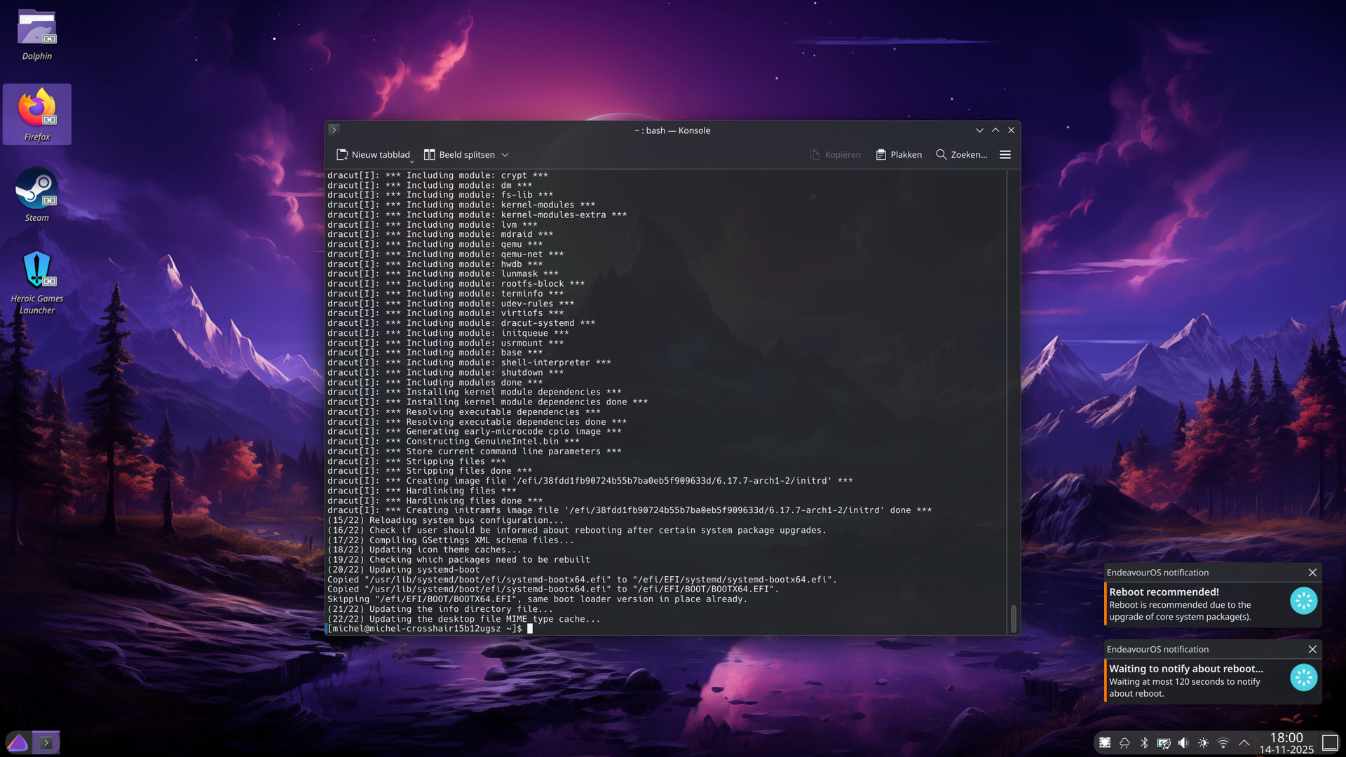

It started happening to me, too (in KDE).

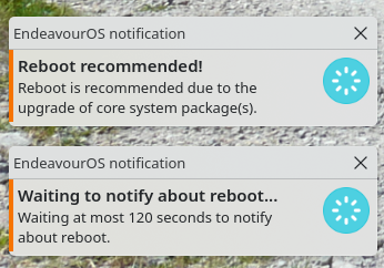

This is what it looks like on my KDE/Plasma system:

My second notebook showed it as well today after updating.
Edit: Primary notebook has it too after updates today
Just finished updating my system and I can’t replicate the issue. Everything normal on my end.
I got the “waiting to notify of reboot up to 120 seconds” notification after I got the notification to reboot.
middle of update: “waiting to notify yadda yadda yadda”
before update is finished: “Reboot Recommended”
1st time ever for me that I got “Reboot Recommended” before the update is finished. Usually right after. Observation.
