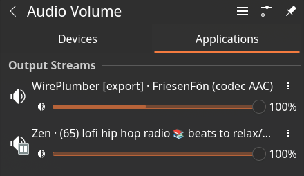

Yes you can, by default with wireplumber you should only have to pair your bluetooth device with your pc and you should see your device in pavucontrol settings
I just tried and didn’t have to do anything, just paired my phone over bluetooth and started music, it came out of the monitor

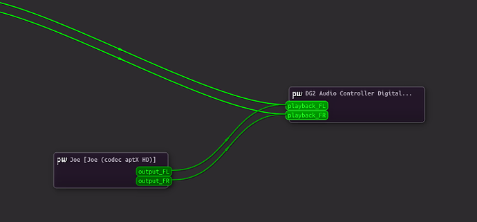

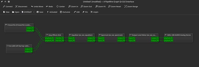

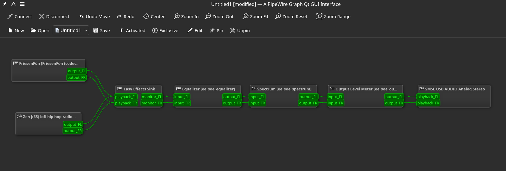

Works like a charm and with could even route the audio from the phone to easyeffects, using qpwgraph

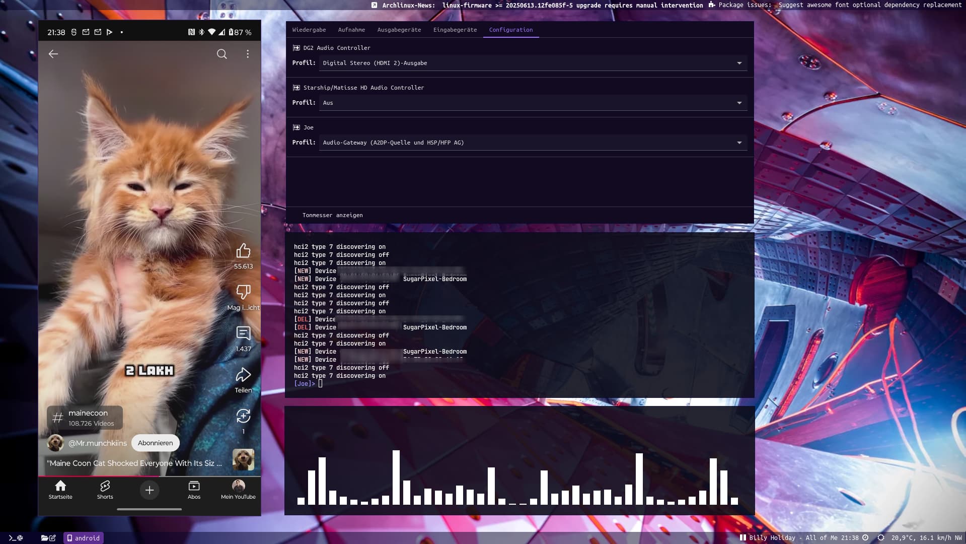

easy :wink: scrcpy
and some smart script that will automatically load it when i plug the phone ..

also cheating as of if use scrcpy it will handle audio also without any Bluetooth..
but if i unplug it will use Bluetoth to pipe audio:
