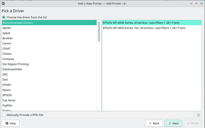

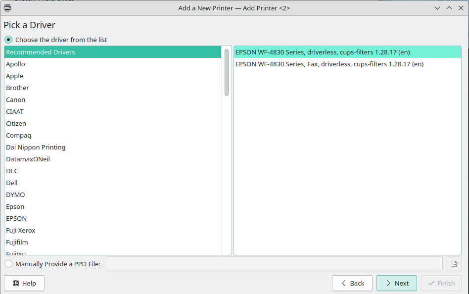

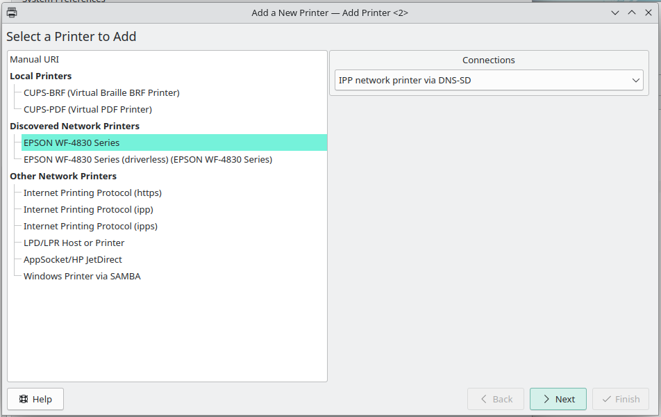

This is true, the question is: Why is it SO much easier on Manjaro than on EOS (or Arch, that is - tested both)? I don’t want to install drivers by hand, because nowadays this can be done automatically with driver-DBs. Something that Windows and Apple do quite easily, and something that Manjaro does quite easy as well - not ootb easy, but almost. If you install a naked Manjaro and follow this guide:
and then try to add a printer within your network you get the following:
followed by:
and that’s that - config done.

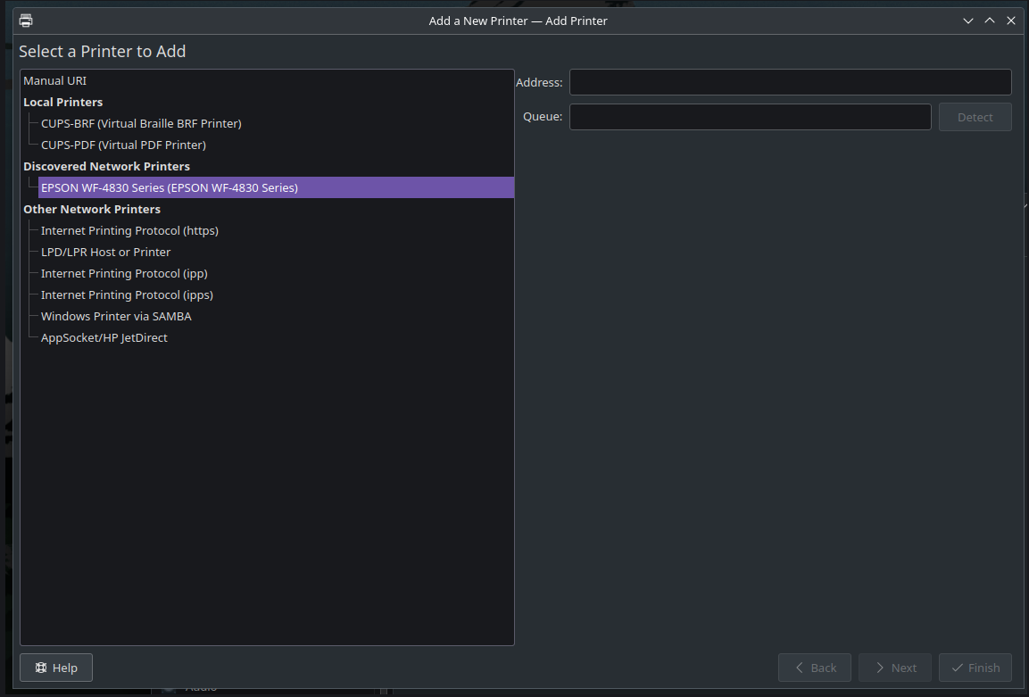

If I do the same on EOS I get this one:
and from there on it is a tom of manual stuff, selecting the correct printer driver, downloading another package, and more stuff which is kinda unnecessary, because it is doable the convenient way. The question is: What is doing Manjaro differently from Arch or EOS? Because as soon as I know that I can mimick it. I tried with the installation of all packages qhich are part of Manjar-Printer, but to no avail.
