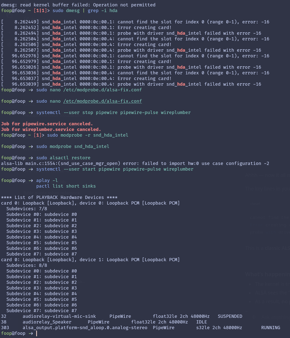

The problem is, for some reason, the PC is struggling to create sound cards (see dmesg output from previous screenshot)
No sound device is available for use because of this. Monitor audio, headphones… nothing. The only playback devices shown in aplay -l are loopback.
