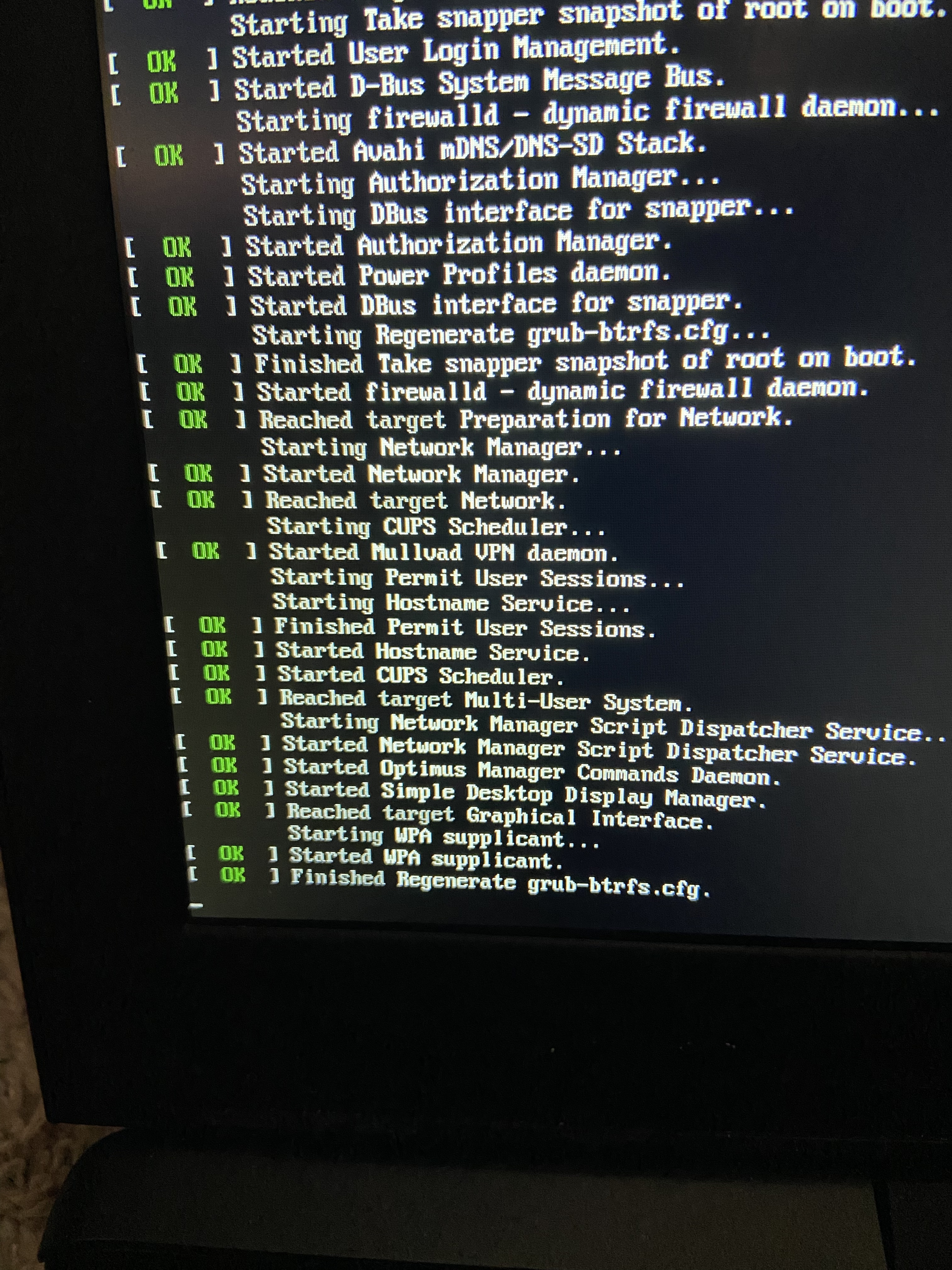

So, great news(sarcasm), I was told by the arch wiki that you can blacklist it from grub, and my idiotic ass tried doing that. Now my system is stuck on this
I think I might have to reinstall…

Just switch to a tty and you should be able to get back into the grub command line or what ever you need to do?
Edit: Just remember if you change something in /etc/default/grub you have to update grub with
That’s what I did. I added something to /etc/default/grub, ran the mkconfig command, rebooted, and my system was just like that.
Would switching to a TTY be possible at this point?
Should be able to try it.
What did you add?
Edit: Should be this i think?
module_blacklist=i915
I read something on the arch wiki saying you were supposed to add module_blacklist=<module> to that file. So I did that with the i915 module.
Reading it again, it says you’re supposed to type that into the grub command line.
Oh wait, did I actually do that correctly?
It has to be in the grub command line in /etc/default/grub and in the line that has everything already there.
Edit: This is the line you have to add it to with space between other entries. You may have other entries also. This is an example:
