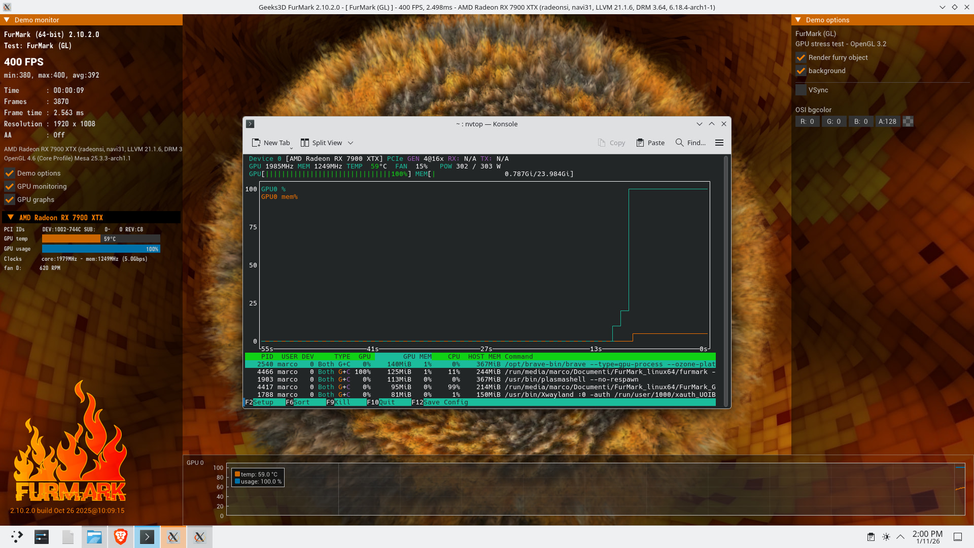

On the live ISO the number is 300 both in nvtop and lact, on the install immediatly after it’s 0.

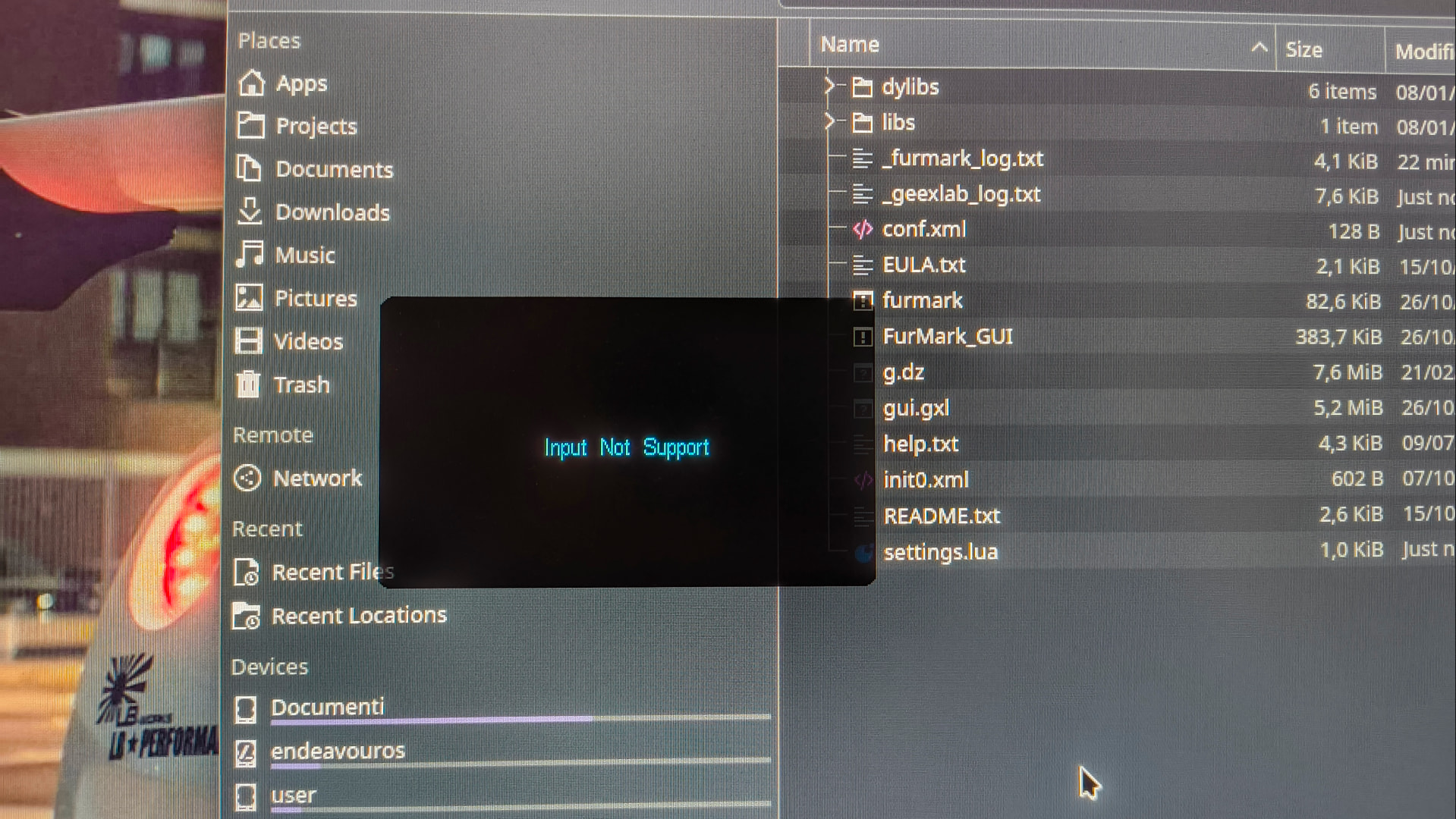

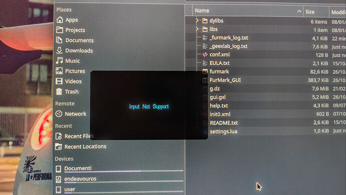

But what? I’m starting to suspect my screen since I get this when forcing VRR (or whatever is “Adaptive sync” in Plasma settings). Testing that because I user had similar problems that were solved by forcing it on.
You’re guessing. And that won’t address your issue. As @ricklinux said: You’re wasting your time.
You’re connected via HDMI. Adaptive sync would require HDMI 2.1 with VRR support. And I strongly doubt it that an older AOC 24" with a refresh rate of 75 Hz would have an HDMI 2.1 port, maybe HDMI 1.4 or so.
And that wouldn’t have any effect on the GPUs performance.

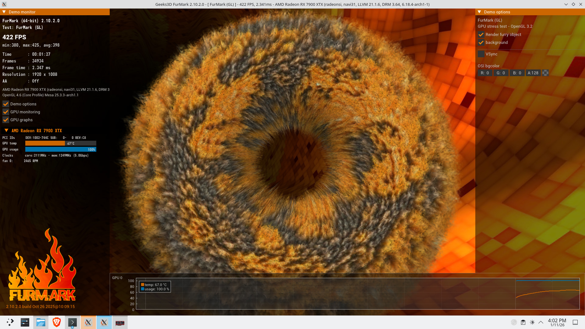

It’s working on Arch, thanks again to everybody who tried to help. I’ll see if I can find what’s causing the problem on EOS (after some rest).

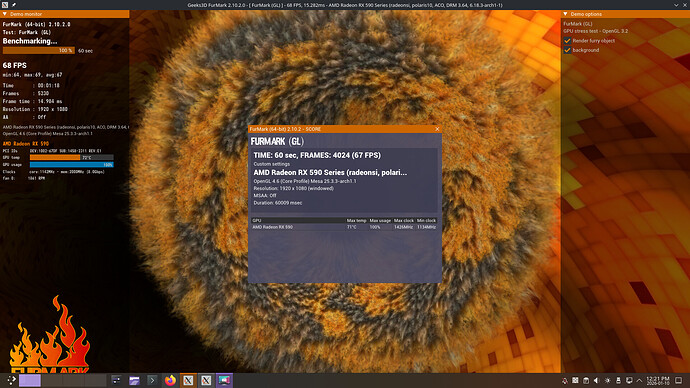

I find this strange. My cards work fine on eos. I have an RX 6750XT also besides the RX 590 which would undoubtedly get way more FPS. Is Arch installed on the same computer? Or is this with the Gpu installed in a different computer with Arch?
Same PC, different disk, tried EOS on that too.
The math isn’t mathing! Doesn’t make any sense. I’m sure if i stuck that card in my system on my eos install it would work.
